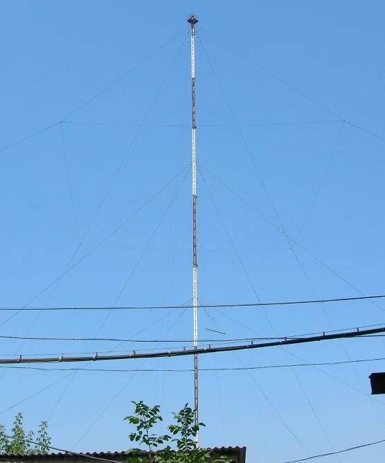

UKR__Odessa Petrivka 1242 {1278} kHz, 30d 20n kW, 150m high mast,
Radio Maiak 765 kHz 100 kW 2 masts

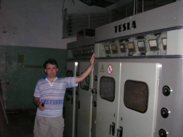

The power usage of the outlets in Petrivka on 765 kHz (Radio Maiak, Odesa)
and 1278 kHz (Voice of Russia) is 75 kW and 50 kW, respectively. The tx on
765 kHz is based on a 20 kW TESLA tx which was modernized and boosted via
40 kW to 75 kW, the unit on 1278 kHz is a 150 kW Shtorm tx which is run on
reduced power.
(Bernd Trutenau via MWDX, Febr 28, 2003; ARC MV-Eko March 17, 2003)

Two MW masts (1x reserve) and more 18 SW masts visible in G.E.

<http://www.frocus.net/images/antennas/ua/Petrivka/Tesla_30kW.jpg>

only, no FM frequency. TX: Petrivka - Odeska Oblast, 70 kW {real 40kW,
max. 75 kW; see picture of 30 kW TESLA tx below}.
